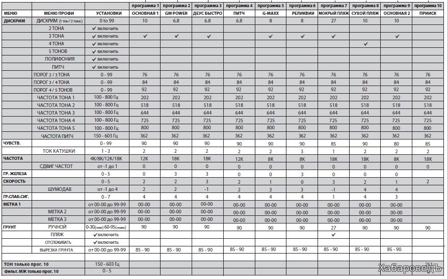

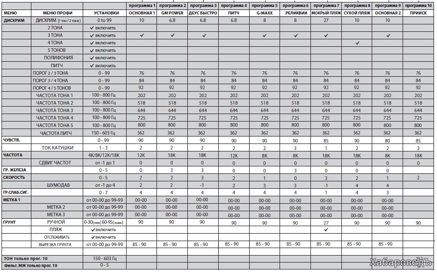

    Alex-morskoy Obergefreiter
    72
    Location:
    Дніпро
  4. 1shion1
    1shion1 Stabsfeldwebel
    31

    Location:
