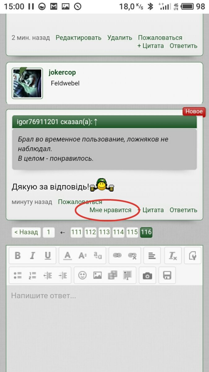

    S00922-150010(1).jpg :beer::beer::beer:
