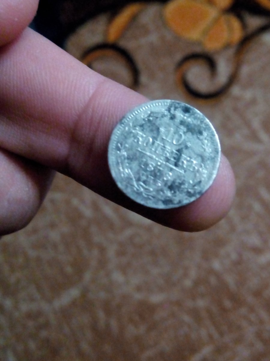

  26. gunslinger888
    gunslinger888 Feldwebel
    400
    Ukraine
