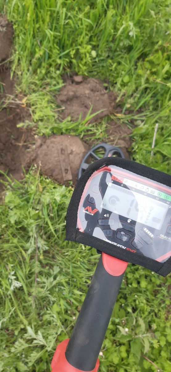

  22. Oleggun
    Oleggun Oberfeldwebel
    662
    Location:
    Motohobiman likes this.
