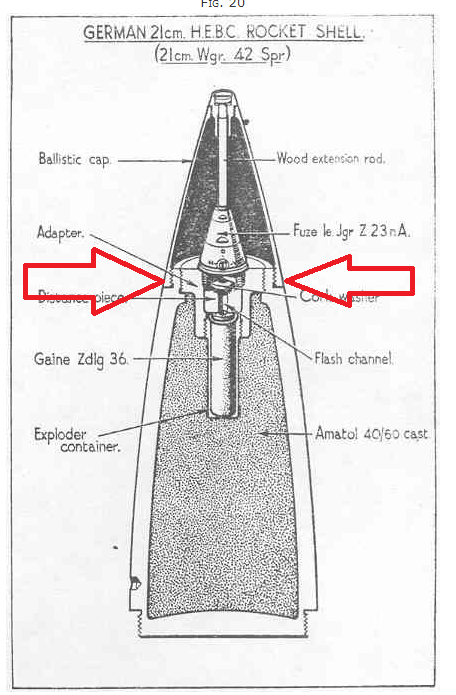

    I would like ask for a help. I found this item, you can see on the pictures, with ca. measurements. I think it was a ballistic cap for any kind of >15cm hauben granate. The nose piece is from aluminium the other part was made from steel. Have you got somebody an idea about this item? Thanks in advance.

    Sorry for the bad photos. I know the fuse isn't in the ballistic cap, there was a wood extension rod between the aluminium nose piece and the fuse. Maybe it was a 21cm Wgr.42. Sprgr ballistic cap?!

    I think the aluminium piece isn't a part of the fuse because it hasn't an inner thread and it hasnt small holes for the centrifugal segments.

    It"s right.
    It may well be.
    In this case, there should be leftover thread :

    It hasn't got a leftover thread. The total length of this item is about 160-170mm. How long the ballistic cap of the 21cm Wgr.42 Sprgr?

    ...i think, about 22 cm. (,count with aluminium cap)
