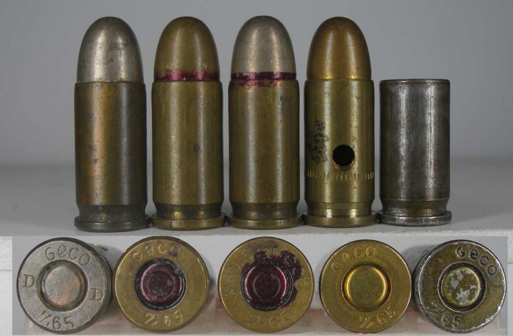

    Вот что JohnMoss пишет на IAA:
    'The 1927 "contract" was actually a working agreement between Rheinisch-Westfälische Sprengstoff A.-G. (RWS) and Gustav Genschow & Co. A.-G. (Geco). Although perhaps over-simplified, basically, it gave Geco the responsibility for making pistol and revolver ammunition for both companies, and RWS the responsibility for rifle calibers. That is why so many handgun cartridges with "GECO" and "RWS" headstamps look identical to each other - they were, from that time, all made by GECO. There are even a few known with "GECO-RWS" headstamps. RWS and Dynamit A.-G., vormals Alfred Nobel & Co., almalgamated in 1931. Dynamit Nobel A.-G. acquired all shares of GECO in 1959, at which time the Gustav Genschow Co. became a limited-liability company.'
    http://iaaforum.org/forum3/viewtopic.php?f=8&t=13971

    Немного раньше обсуждали этот ворос:
    In 1927 a contract was made between RWS and Gustav Genschow & Co (Geco). The content of this agreement was as follows: The pistol cartridges and shotshells of both companies would be manufactured in the Durlach plant of Genschow and the rimfire-, revolver-, and Flobert-cartridges, the primers, cases and air gun pellets of both would be manufactured in the RWS plants in Nuremberg and Stadeln. The shotshell cases of RWS were still manufactured in Nuremberg. This contract applied from 1929 onwards. In 1931 RWS became a part of the Dynamit Nobel Co. but nothing changed: RWS was purely a sales organization for RWS products. The production of military ammunition was not a part of the 1927 agreement. The headstamp “RWS-Geco” is not a product of the transitional period; it was used by the RWS plant in Danzig. I am preparing a report about this subsidiary factory of RWS.

    Обсуждение то не развилось. Ничего нельзя исключать, но имеются сомнения. Данциг в то время был под польским контролем, да и далекова-то от Крлсруэ с Нюрнбергом.

    Инфа из :
    Die Patronenladestation der RWS - Geco in Danzig von 1930 - 1940

    Тогда вот выдержки ... раз уж никто не хочет переводить, то и я не буду ;)
    "Als Polen 1929 einen Zollkrieg gegen das Deutsche Reich eröffnete, geriet die Firma "Diana Waffen- und Munitionsbetrieb in Danzig", die die Vertretung von Genschow und RWS besaß, in Schwierigkeiten. Der Zoll auf fertige Produkte betrug 168 $ / 100 kg, also ca. 7 Reichsmark / kg, d.h. der Zoll betrug das 2-3 fache des Einstandspreises der Patrone. Man entschloss sich daher, für die gängigsten Patronen eine Fertigung in Danzig aufzubauen, die Komponenten sollten von Stadeln geliefert werden (Zoll RM 0,40 / kg). Maschinen und Werkzeuge wurden Ende 1929 auf den Weg gebracht, auch ein Fertigungsmeister aus Stadeln (Herr Trautner), ging nach Danzig . Die Fertigung begann mit Revolverpatronen .320, .380, Lefaucheuxpatronen 7 und 9mm, Flobertpatronen 6 und 9mm, sowie Pistolenpatronen 6,35 und 7,65 mm, dazu Luftgewehrkugeln verschiedener Kaliber."
    "7. Juni 1930
    Der Senat der Freien Stadt Danzig gestattet die Fertigung der Pistolen- und Revolverpatronen. "
    "11.September 1930
    Bestellung für Danzig: 100 kg Haslocher Pistolenpulver 42 b, 150 kg WPP grün Walsroder Pistolen - Pulver. 1 Million Geschoße 6,35mm und 500 000 7,65mm. "
    16. September 1930
    Genschow schreibt an RWS: "...wir haben ca. 30 000 Hülsen beider Kaliber (6,35 u. 7,65)fertig, haben aber keine Bedenken, diese für einen anderen Exportauftrag einmal zu verwenden, denn die Hauptsache ist ja unser Firmenzeichen "Geco" und die Kaliberbezeichnung und zweifeln wir daran, dass irgend ein Kunde den Unterschied, dass anstelle der beiden "D" die Sternchen stehen, beobachten wird". Originaltext. Wer sie wohl geladen hat, Durlach oder Danzig?

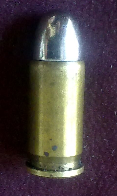

    Между увиденной маркировкой фото патрона и моей есть разница в прописке названия фирмы. Как понимаю разница из-за качества сохрана. Но хотелось бы знать точное название фирмы... Кто подскажет? А также, чья она?

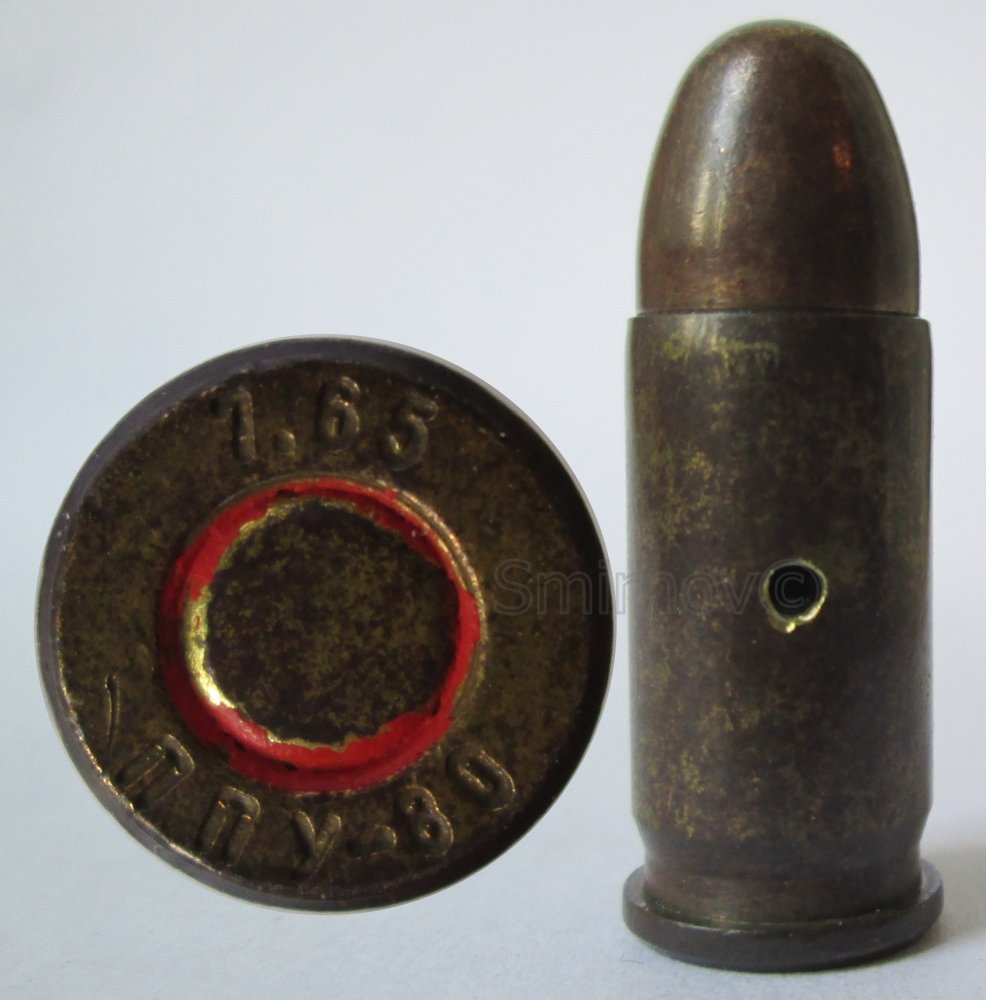

    Први Партизан Ужице 1980 год
    Unnamed Player подобається це.

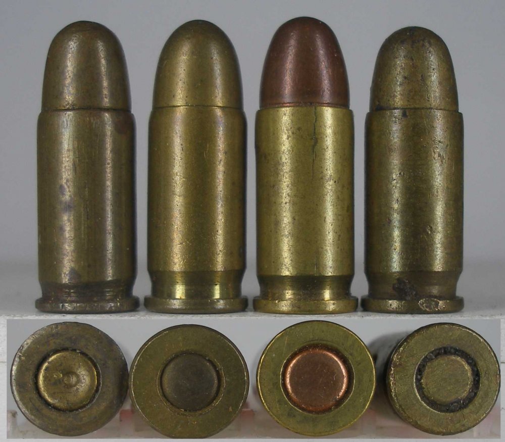

    Киргизия
    Мои пять копеек.Турки. Три различных варианта кернения капсюля. Найдены в Киргизии. И что самое интересное подняты с одного места. MKE 7.65.JPG
