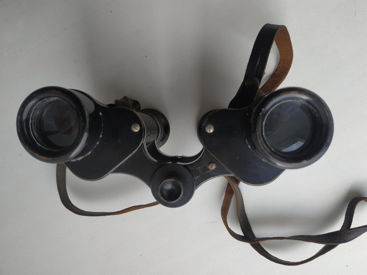

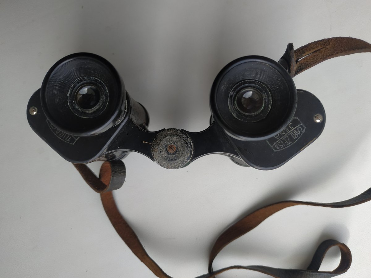

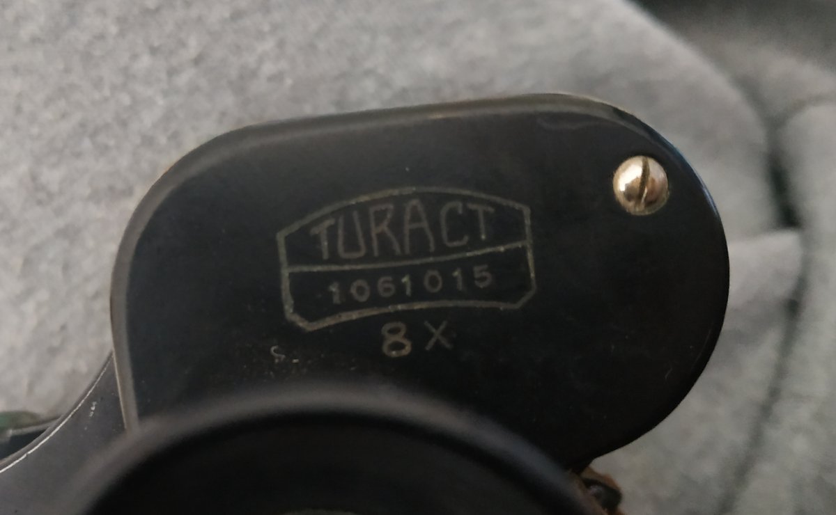

    Привіт всім! Допоможіть визначити рік бінокля Carl Zeiss Jena Turact 8х
    Буду вдячний за інформацію!

    можно больше фото целого бинокля
    https://www.worthpoint.com/worthopedia/carl-zeiss-jena-telact-x-24-248866962
    https://binocollection.com/catalog/binoculars-carl-zeiss-jena-telact-8x.html
    https://translate.google.com.ua/?hl=ru#view=home&op=translate&sl=en&tl=ru&text=In 1907, Carl Zeiss radically changed the framework and the design of his binoculars, replacing "civilian"%20models%20Feldstecher%206%20Fach%20by%20Telex%2C%20Feldstecher%208%20Fach%20by%20Telact%2C%20Jagdglas%20by%20Silvamar%20and%20Feldstecher%2012%20Fach%20by%20Telefort.%20The%20new%20devices’%20detailed%20characteristics%20were%20published%20in%20the%2074-th%20volume%20of%20Carl%20Zeiss%20catalog%20in%20August%201907.%20The%20optical%20characteristics%20were%20significantly%20improved%20in%20new%20devices%20(the%20field%20of%20view%20and%20the%20objective%20diameter%20were%20increased%2C%20optical%20aberrations%20were%20decreased)%2C%20and%20the%20devices’%20design%20was%20also%20changed%3A%20the%20central%20hinge%20and%20the%20“lugs”%20for%20a%20neck%20strap%20were%20not%20attached%20to%20binocular%20with%20the%20help%20of%20screws%20any%20more%2C%20they%20became%20integral%20with%20it%20instead%2C%20an%20eccentric%20objective%20alignment%20system%20appeared%20and%20its%20frame%20design%20was%20also%20changed%2C%20the%20prism%20covers%20spanned%20the%20binoculars’%20carcass%2C%20and%20they%20were%20lubricated%20with%20a%20special%20compound%20at%20the%20joint%20points%20in%20order%20to%20improve%20impermeability.%20Moreover%2C%20the%20prisms%20inside%20the%20binoculars%20were%20no%20longer%20pressed%20by%20prism%20covers%20–%20they%20were%20fixed%20with%20the%20help%20of%20special%20flat%20springs%20instead.%20It%20helped%20increasing%20the%20device’s%20reliability%20greatly.%20Actually%2C%20the%20binoculars%20have%20survived%20in%20such%20appearance%20up%20to%20present%20days%20(see%20Hans%20T.Seeger.%20Zeiss-Feldstecher%2C%20Handfernglaser%20von%201894-1919%2C%20Modelle-Merkmale-Mythos%2C%20pp.399-414)%20%0A%20%20%20Telact%20is%20a%20new%20design%20fine%20model%20with%20perfect%20optical%20features%2C%208x%20magnification%20and%20a%2024mm%20lens.%20It’s%20a%20civilian%20model%3B%20similar%20military%20models%20are%20marked%20as%20D.F.8x%2C%20D.F.8x24%20and%20D.F.95%20n%2FA.%0A%20%20%20The%20binocular%20“civilian”%20use%20is%20proved%20by%20the%20central%20hinge%20clamp’s%20(fastener’s)%20small%20diameter%20(see%20photo)%2C%20which%20has%20a%20hole%20for%20a%20knob%20(included%20to%20binoculars%20delivery%20kit)%2C%20with%20the%20help%20of%20which%20the%20hinge%20could%20have%20been%20finally%20fixed%20depending%20on%20the%20observer’s%20interpupillary%20distance.%20There%20is%20an%20interpupillary%20distance%20scale%20on%20the%20upper%20hinge%20disc.%20Telact%20was%20produced%20in%203%20versions%20with%20various%20design%20changes%20until%201915%20%3A%0A%20%20%201st%20version%3A%20in%20which%20the%20cap%20of%20frame%20lens%20and%20the%20lower%20prismatic%20cover%20were%20made%20as%20a%20single%20part%20(since%201907)%20and%20the%20eyepiece%20case%20had%20the%20“transverse”%20knurling%20(see%20photo)%0A%20%20%202nd%20version%3A%20with%20the%20two-ring%20type%20lens%20frames%20(starting%20from%201908%20and%20up%20to%20the%20end%20of%201914)%3B%0A%20%20%204th%20version%3A%20with%20the%20rounded%20lens%20covers%20(from%201913%20to%201915)%0A%20%20%20This%20device%20(1st%20version)%20possesses%20eyepieces%20of%20the%20so-called%20"1%2F3"%20design%20(see%20Hans%20T.Seeger.%20Zeiss-Feldstecher%2C%20Handfernglaser%20von%201894-1919%2C%20Modelle-Merkmale-Mythos%2C%20p.117)%20with%20the%20base%20diameter%20equal%20to%2024.5%20mm%20and%20the%20top%20prism%20cover%20width%20equal%20to%2050%20mm%20(see%20photo).%20The%20eyepieces%20possess%20a%20diopter%20scale%20and%20a%20transverse%20knurling.%20The%20binoculars’%20case%20height%20(including%20upper%20prism%20cover)%20is%20equal%20to%2066%20mm.%0A%20%20%20There%20are%20inscriptions%20“Carl%20Zeiss%20Jenna”%20on%20the%20left%20prism%20cover.%20There%20is%20also%20an%20inscription%20“Telact%20155284%208x”%20on%20the%20right%20prism%20cover.%20The%20inscription%20is%20encrusted%20with%20the%20help%20of%20silver%20alloy%20and%20is%20made%20in%20block%20letters%20against%20the%20background%20of%20Carl%20Zeiss%20Tessar%20photo%20lens%20schematic%20image.%0A%20%20%20The%20binocular’s%20serial%20number%20is%20“155284”%20and%20it%20was%20released%20as%20a%201000%20pieces%20batch%20in%201908.%0A%20%20%20An%20early%20model%20having%20the%20Telact%208x%20design%20and%20the%20Feldstecher%208%20Fach%20marking%20with%20the%20eyecups’%20rare%20shape%20and%20narrower%20loops%20for%20a%20neck%20strap%20is%20available%20by%20the%20following%20link%3A%20http%3A%2F%2Fbinocollection.com%2Fcatalog%2Fbinoculars-carl-zeiss-jena-feldstecher-8-fach-2.html%0A%20%20%20Late%20model%20with%20the%20rounded%20lens%20covers%3A%20http%3A%2F%2Fbinocollection.com%2Fcatalog%2Fbinocular-carl-zeiss-jena-telact-8x-1.html%0A%20%20%20In%201909%2F10%2C%20the%20binoculars%20model%20with%20central%20focusing%2C%20named%20Telactem%208x%2C%20was%20released.%20It%20is%20available%20by%20the%20following%20link%3A%20%20%20http%3A%2F%2Fbinocollection.com%2Fcatalog%2Fbinoculars-carl-zeiss-jena-telactem-8x.html%0A%20%20%20In%201912%20the%20Telact%208x%20binoculars%20were%20replaced%20by%20the%20Turact%208x%20model%20(the%20latter%20named%20binoculars%20were%20produced%20simultaneously%20with%20Telact).%20It%20became%20lighter%20and%20smaller%20than%20its%20predecessor%2C%20but%20worse%20in%20optical%20characteristics.

    Я так розумію він 1907року

    " в 1912-м году вышла модель Turact 8x (бинокль выпускался параллельно с Telact-ом). Он стал намного легче и меньше предшественника, однако хуже по оптическим характеристикам."

    Доброго!
    Судя по инфе отсюда
    http://home.europa.com/~telscope/zeissbn2.txt
    Модель Turact 8x24 серийно выпускалась в 1914-1933 гг. Номера 1000000-1550000 относятся к диапазону 1919-1930 гг. Так что можно предположить, что предмет Веймарский, начала 20-х.

    Дуже дякую вичерпну інформацію.

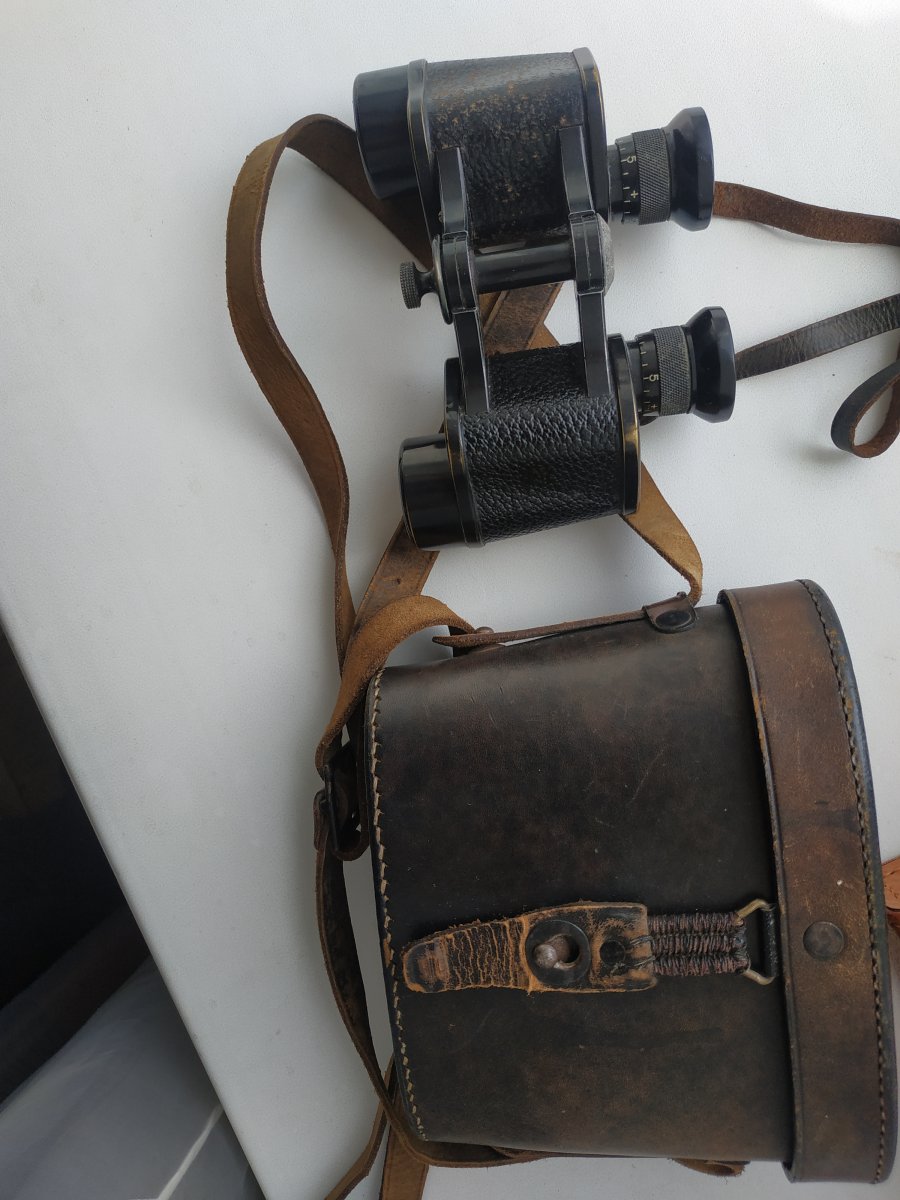

    1920-й год выпуска. Кофр - оригинальный. Верхние призменные крышки - сплав цинка (у немцев напряг с цветными металлами после войны).

    Turact выпускался не с 1914-го, а с 1912-го года.
